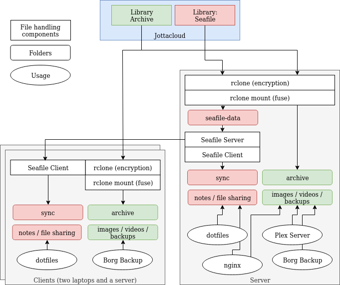

So my life now looks like this! ↓
In short; I now got two folders on every client (desktops and servers) I use
where sync is an Seafile folder with offline content, and archive; being a
slower, albeit unlimited, file system folder. With this I can edit and use my
notes and daily files via the former, and run borg backup 2, image/video gallery
etc in the latter.

Run rclone config to add your preferred cloud storage resources. Add
additional layers with encryption. I divided the two use cases, but one remote
folder with two subfolders is also a possibility. 3
torvald@gauda ~ $ rclone listremotes --long
jotta-archive-encrypted: crypt
jotta-archive-raw:       jottacloud
jotta-sync-encrypted:    crypt
jotta-sync-raw:          jottacloud
Further, rclone allows us to mount external resources to your file system with
rclone mount. Make it persistent with systemd.
[Unit]
Description=Mount jotta crypt archive
Wants=network.target
Before=network.target
[Service]
Type=forking
User=torvald
Group=torvald
WorkingDirectory=/home/torvald
ExecStart=/usr/bin/rclone mount --allow-other --daemon jotta-archive-encrypted: /home/torvald/jotta/archive
[Install]
WantedBy=multi-user.target
Seafile comes with a well written guides for both server setup as well as
desktop
and CLI clients.
Seafile's data directory is simply pointed to my rclone mounted sync folder.
The default SQLlite did not work well with this approach, so I set up a Seafile
with MySQL. No PostgreSQL support is a bummer.
